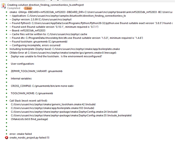

  • Thank you very much for your reply but I have not been able to solve the problem yet.

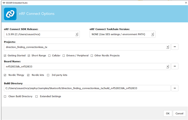

    I have been able to download and use the latest version and I keep getting the same error, I have followed the installation process of the SDK version and I can't find the error. I have tried to complete the project with the nrf52833dk_nrf52833 board and I get the attached errors. Could it be a configuration error of the Segger embedded Studio? how should it be configured?

  • Hi again
    It seems like you haven't chosen an nRFConnect Toolchain version, and that you use the SES settings/environment path. Have you set up the toolchain as explained in step 7 (Set up the build environment in SES) of the getting started guide?
    Here is the .hex file of the application built on our side to make the application run as expected. It should be sufficient to flash it onto an nRF52833 DK using the nRFConnect programmer app for instance:
    6864.zephyr.hex
    Simon
