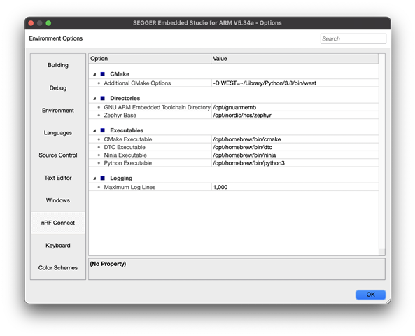

Facing problems to start with nRF5340DK on Segger studio with Apple M1 on MacOs 11.3
After configuring the options for an nRF project, segger studio cannot create the project by warning me the error: "create_nordic_project.py failed"
The problem seems to come from ninja which is not found by cmake:
CMake Error: CMake was unable to find a build program corresponding to "Ninja".  CMAKE_MAKE_PROGRAM is not set.  You probably need to select a different build tool.
Complet log of the error :

My project configurations :
My nRF Connect options :
Segger studio nRF connect options
Some useful informations about my configurations :
$PATH
/usr/local/bin:/opt/homebrew/bin:/opt/homebrew/sbin:/opt/homebrew/bin:/opt/homebrew/sbin:/usr/local/bin:/usr/bin:/bin:/usr/sbin:/sbin
$ZEPHIR_BASE
/opt/nordic/ncs/zephyr
which ninja
/opt/homebrew/bin/ninja
ninja --version
1.10.2
which cmake
/opt/homebrew/bin/cmake
cmake --version
cmake version 3.20.1
CMake suite maintained and supported by Kitware (kitware.com/cmake).
Software version :
Segger studio for ARM - 5.34a
nRF SDK - 1.5.99
MacOs - 11.3 on Apple M1
