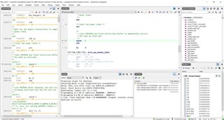

nRF5340-DK & CCS811 sensor, doesn't reach main()
I'm working with the CCS811 sensor example from the `v1.5.1/zephyr/samples/sensor` folder and I managed to compile it successfully after modifying the files in the `ccs811/boards` directory. When I debug the solution, the debugger enters in continued execution mode and never reaches the main() function. Every time I hit  "Pause", the code always pauses in the same place, as it is shown in the following screen capture:

  • Hi Simon, thanks for your help!
    Evidently, the execution hangs inside cs811_init(), concretely in the k_msleep() function:

    If I comment k_msleep(1); the code goes on forward, but it gets stuck again in any subsequent k_msleep() instance. If I comment out every instance of k_msleep(), the code reaches the main() function.
    Could it be an issue with the clock configuration? Any hint about what could be the cause?
    I didn't get any hard fault errors in the serial terminal.
    Thanks in advance!
    EDIT:
    Nevermind, I changed the following pins in my nrf5340dk_nrf5340_cpuapp.overlay:
    sda-pin = <34>; // P1.02 (34)
    scl-pin = <35>; // P1.03 (35)
    irq-gpios = <&gpio0 36 GPIO_ACTIVE_LOW>; // P1.04 (36)
    And now it runs fine without hanging in the k_msleep() instances. Perhaps, the sensor wasn't responding because of a conflict with the pins I was trying to use and that was causing the processor to hang in the css811_init() function? Not sure though...
