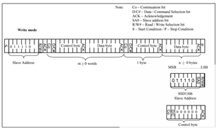

I am using the twi_sensor example of the sdk12.3 in a NRF51822
Taking a look on the tx function:
    err_code = nrf_drv_twi_tx(&m_twi, MXC400_ADDR, reg, sizeof(reg), false);
I see that you can only send group of bytes... (reg) ..
But some devices like some screens with the ssd1306 driver has this structure:
As you can see after the ACK there are 2 bits and then the 8 bit command...
How can i deal with this with the function shared before?
Thank you so much in advance.
