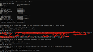

Hi, I'm following the Buttonless DFU Template Application on nRF52 DK (PCA10040), SDK 17.0.2. From my understanding, we need to use the following codes to merge the following 4 hex files:
4 Files
1) s132_nrf52_7.2.0_softdevice.hex
2) ble_app_uart_pca10040_s132.hex (My own application's output hex file )
3) bootloader_setting.hex
4) secure_bootloader_ble_s132_pca10040.hex (Provided application "secure_bootloader" output hex file )
Code:
mergehex.exe -m ble_app_uart_pca10040_s132.hex   s132_nrf52_7.2.0_softdevice.hex  -o  sd_and_app.hex
mergehex.exe -m sd_and_app.hex   bootloader_setting.hex  -o  sd_app_setting.hex
mergehex.exe -m sd_app_setting.hex   secure_bootloader_ble_s132_pca10040.hex  -o  sd_app_boot_setting_complete.hex
Then, use nRF Connect --> Programmer, earse the board, then drag and drop hex file sd_app_boot_setting_complete.hex to "File Memory Layout (red box)".
However, on my mobile phone's nRF Connect App, it didn't detect any Nordic BLE device. Anything wrong in my procedure, please?
