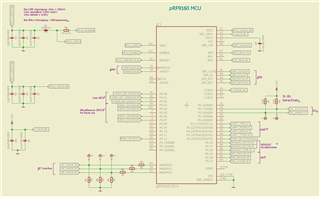

Hello everyone.
I have designed a custom board using the nRF9160.
Everything seems to be working fine. Now I want to measure the current drawn by the nRF9160.
I made the most basic application which essentially does nothing.

I think I disabled as much as I could.
I want to achieve the lowest possible idle current consumption.
With the Nordic Thingy91 i get around 2-4µA, which is as expected.
But when I use my custom board I get around 2,8mA with the same firmware!
Even when I put the nRF9160 to deep sleep with nrf_regulators_system_off(), I still get 2,8mA.
The datasheet says the active current consumption of the nRF9160 is around 2,2mA, which is kind of in the same area.
The Thingy91 I have, has the the nRF9160 SICA B0.
The prototype I have designed has the nRF9160 SICA B1, so the newer generation I guess.
Is there something I didn't consider when it comes to a custom board?
Could it be a design error, that it always drains around 2,8mA, even if the nRF9160 does nothing and all GPIO pins (except I2C) are diabled?
Here is my nRF9160 with all the connections.
Thank you!
  • Hi, since the same code is at 2-4uA on the thingy91 I have a feeling that there is something else on your board that is consuming current. But first, just to check, you have flashed the modem FW on the nRF91 SIP, and you know that the modem core is working right?
    I see that you have an accelerometer and an EEPROM, these probably will have to be initialized first to put them in a low power state. Also the I2C/SPI lines connected to these external components will have to be set to a defined level, unless the external components will most likely start to behave weirdly as you don't have any external pullups, and the lines will then be floating.
    May I ask how you measure current, what type of equipment, and where on your board you are measuring current/powering the device?
    Thank you for your response.
    I just figured out the problem. The GPIO pins weren't the problem. The modem seemed to be the problem for some reason. Flashing the newest modem firmware was the first thing I did, when I got the board.
    But I didn't add the modem lib entry CONFIG_NRF_MODEM_LIB=y in my prj.conf.
    I wanted to test something with the modem, so I flashed a firmware with this configuration set and I noticed a lower current.
    So I tried using it with my minimalistic firmware as I shared in the original post and now it works and I have a sleep current of around 3-5 µA!
    When I set CONFIG_NRF_MODEM_LIB=y in my prj.conf file, I get the expected 4-5 µA sleep current. When I don't, I get 2,8 mA sleep current.
    The application code is the same in both cases.
    It seems like this triggers some startup-code that properly disables the modem.
    Could that be the case?
    My modem firmware version is 1.2.3
    So it works with this prj.conf:

  • Ok, thanks for reporting back.
    Yes, the modem has to be disabled properly, and this is done through the modem libs, so it makes sense.
