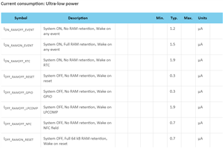

Hi. I'm evaluating the nRF52810 chip by developing on the nRF52-DK (based in nRF52832 chip). As noted in this chapter https://infocenter.nordicsemi.com/topic/sdk_nrf5_v17.0.0/nrf52810_user_guide.html - it's possible to emulate nRF52810 chip on the nRF52832 chip by using corresponding code and softdevice. So I need to evaluate the power consumption in the deepest sleep mode (System Off). But I found some difference between Electrical specifications of this two chips in the tables of sleep modes and power consumptions:
For nRF52832 is:
and for nRF52810 is:
So, if I understand correctly - are the sleep modes different on these two microcircuits? For example, the "IOFF_RAMOFF_GPIO" sleep mode does not exist on the nRF52810 chip? And if so, is the measured current on the nRF52832 correct by emulating the nRF52810?
