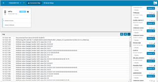

I upgrade a device via 'Bluetooth Low Energy', Could you help to explain the data format? Or some
protocol file.
The protocol is not extensively documented, but you can refer to the DFU protocol documentation and look at the implementations I have mentioned.
