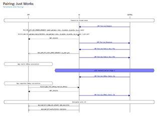

I would like to modify the example "ble_thread_dyn_mtd_coap_cli_nfc" to use Just Works pairing instead of OOB with NFC.
To do this, I modified this in sdk_config.h:
#define NFC_BLE_PAIR_LIB_ENABLED 0
#define NFC_PAIRING_MODE 2

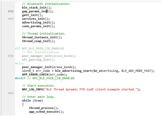

I added this in main.c:
/**@brief Function for handling Peer Manager events.
 * @param[in] p_evt  Peer Manager event.
static void pm_evt_handler(pm_evt_t const * p_evt)
    pm_handler_on_pm_evt(p_evt);
    pm_handler_flash_clean(p_evt);
/**@brief Function for the Peer Manager initialization.
 * @param[in] erase_bonds  This flag informs if existing bonds should be erased.
void peer_manager_init(bool erase_bonds)
    ret_code_t err_code;
    err_code = pm_init();
    if (erase_bonds)
        err_code = pm_peers_delete();
    sec_param.bond = false;//true;
    sec_param.mitm = false;
    sec_param.lesc = 1;
    sec_param.keypress = 0;
    sec_param.io_caps = BLE_GAP_IO_CAPS_NONE;
    sec_param.oob = false;
    sec_param.min_key_size = 7;
    sec_param.max_key_size = 16;
    sec_param.kdist_own.enc = 0;//1;
    sec_param.kdist_own.id = 0;//1;
    sec_param.kdist_peer.enc = 0;//1;
    sec_param.kdist_peer.id = 0;//1;
    err_code = pm_sec_params_set(&sec_param);
    err_code = pm_register(pm_evt_handler);
And I added this in the while(true) of the main():
err_code = nrf_ble_lesc_request_handler();
I think I forgot something because I can connect but there is no pairing. Do you know why ?

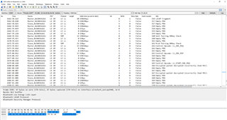

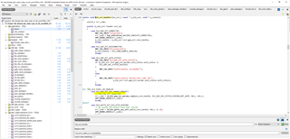

  • Now it works: I had to comment out "case BLE_GAP_EVT_SEC_PARAMS_REQUEST:" in ble_evt_handler ().
    But I still have a small problem: when I connect with nRF Connect, it asks me twice if I want to pair myself? (I am using a Samsung S10)
    Here are the logs.
    4760.Test.pcapng
  • In fact, I only have this problem on my Samsung S10 (Android) and not on my Iphone (IOS).
    This problem is also in the Nordic examples when connecting with an Android.
    When I want to connect to a device and I accept the piring when I receive a message to ask me, I see that I am then sending these messages:
    Then I am asked a second time if I want to pair myself. If I accept, it then sends these messages:
    Do you also have this problem with your Android phones on your Nordic examples?
    Do you have any idea why or if it would be possible to correct this problem?
    Thank you

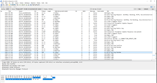

  • Also, I find that if I press "cancel" when it asks me to pair myself for the second time, that I get the error "BLE_GAP_SEC_STATUS_NUM_COMP_FAILURE" in the nrf52840. Why am I getting this error even though I have enabled these options?
        sec_param.lesc = 1;
    Here is the Wireshark log if I hit "cancel" on the second message:
    6406.Test.pcapng
