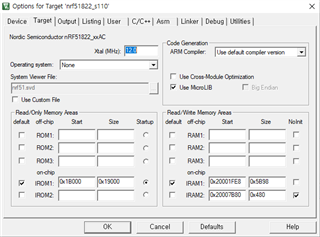

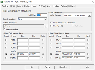

I am using nrf51822/SD-130/SDK-12.3 now.
In order to preserve values ​​after reset, no init was set in the IRAM area.
The setting area is Start: 0x20007B80 / size: 0x480.
For testing, NVIC_SystemReset() is executed at regular intervals, and the value of the relevant area is checked using RTTviewer.
The results appear different in the two circumstances.
1. Softdevice download / keil rebuild and debugging condition
 - Here, the value is preserved after reset.
2. Hex file download – made using build batch file (softdevice + application + bootloader)
 - Here, the value is erased after reset.
 - There was no special problem with the build batch file.
 - I attach my batch file.
I'm looking for which problem is.
Would you give me some advice?
 Thanks.

    Have you allocated the same ".no_init" region in both the bootloader and the application, and do you see the same if you only program the Softdevice+application without the bootloader?
    Vidar
  •  Hello,
    I modified the area in the *.ld file as below.
    I solved it quickly thanks to your advice.
    Thank you.
