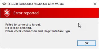

I've got the gaming mouse dev kit and I'm stuck trying to get it programmed using my nRF52840-DK. See my hardware connection image below.

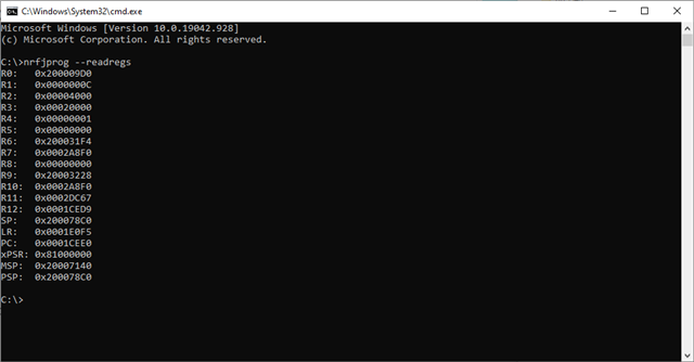

If I leave the mouse power switch off, then it seems to just program the dev kit's onboard processor and not my mouse. If I turn on the mouse power switch I get a "no idcode detected" popup. I tried flipping the debug adapter thing that plugs into the mouse over and I got the same behavior. Any ideas?
I may also have a problem with my project as this is the first time I've used Zephyr - but at the very least I think I should be getting to the point of erasing the mouse so that it doesn't work anymore - but it's still got its factory programming on it (I attempted to customize the project in a recognizable way by changing CONFIG_BT_DEVICE_NAME in autoconf.h... hopefully that's the right way to do that)
