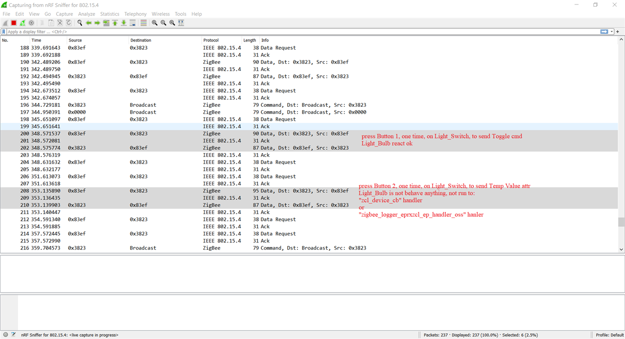

* This is my situation:

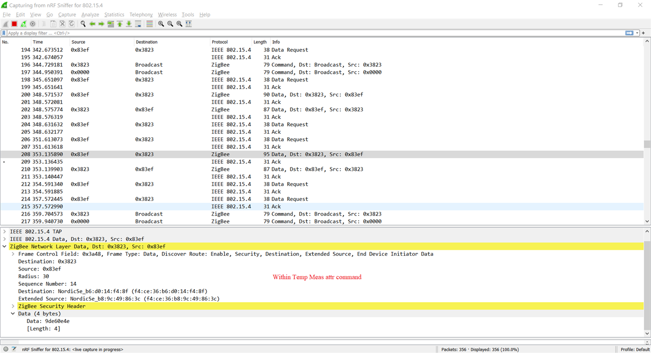

* And below figure, I think "Light_Switch" have trans out, but "Light_Bulb" can't get (just only Temp request):

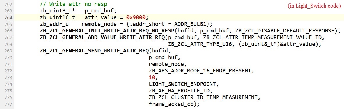

* This transmit segment on "Light-Switch":

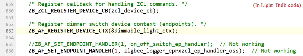

* This register for receiving on "Light-Bulb":
I also saw in https://infocenter.nordicsemi.com/index.jsp?topic=%2Fsdk_tz_v4.1.0%2Fgroup__read__attr__command.html but not clear
Please give me advice for how to catching Temp attr request.

            // Write attr no resp
            zb_uint8_t*   p_cmd_buf;
            zb_uint16_t   attr_value = 0x9000;
            zb_addr_u    remote_node = {.addr_short = ADDR_BULB1};
            ZB_ZCL_GENERAL_INIT_WRITE_ATTR_REQ_NO_RESP(bufid, p_cmd_buf, ZB_ZCL_DISABLE_DEFAULT_RESPONSE);
            ZB_ZCL_GENERAL_ADD_VALUE_WRITE_ATTR_REQ(p_cmd_buf, ZB_ZCL_ATTR_TEMP_MEASUREMENT_VALUE_ID,
                                                    ZB_ZCL_ATTR_TYPE_U16, (zb_uint8_t*)&attr_value);
            ZB_ZCL_GENERAL_SEND_WRITE_ATTR_REQ(bufid,
                                              p_cmd_buf,
                                              remote_node,
                                              ZB_APS_ADDR_MODE_16_ENDP_PRESENT,
                                              10,
                                              LIGHT_SWITCH_ENDPOINT,
                                              ZB_AF_HA_PROFILE_ID,
                                              ZB_ZCL_CLUSTER_ID_TEMP_MEASUREMENT,
                                              frame_acked_cb);

        /* Register callback for handling ZCL commands. */
        ZB_ZCL_REGISTER_DEVICE_CB(zcl_device_cb);
        /* Register dimmer switch device context (endpoints). */
        ZB_AF_REGISTER_DEVICE_CTX(&dimmable_light_ctx);
        //ZB_AF_SET_ENDPOINT_HANDLER(1, on_off_switch_ep_handler);  // Not working
        ZB_AF_SET_ENDPOINT_HANDLER(1, zigbee_logger_eprxzcl_ep_handler_oss);  // Not working
