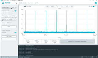

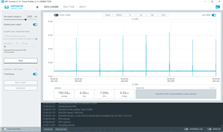

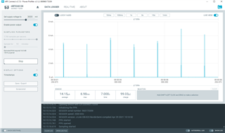

        I am having some issues with running QSPI on the nRF5340DK board.
After I disabled the QSPI, I found the board still having a high current consumption of 700 uA.
Although I tried trying edit source code follow the nrf52840_errata [122] docs which had a similar problem. But I still can't fix the problem.

    At what frequency is the scalable QSPI input clock (PCLK192M) running at? This can be configured in register HFCLK192MCTRL. When running at the full 192MHz speed the device uses more current (with a sleep current of ~700uA).
    To lower the sleep current consumption you would need to configure the QSPI to a lower frequency during sleep. Scaling this down to 96MHz (divide by two) should give much better numbers. Depending on the use-case reducing, the frequency just around CPU sleep should be a viable option. This is described closer under Voltage and Frequency Scaling in the PS.
