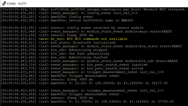

    CONFIG_BT_CTLR should be disabled for the application core, since the network core is used for the bluetooth controller.
    You are getting a warning regarding SETTINGS_FCB not being chosen. If you want Settings with FCB you should uncomment all these lines, comment them all out if you don't want it:
    #CONFIG_FLASH=y
    #CONFIG_FLASH_PAGE_LAYOUT=y
    #CONFIG_FLASH_MAP=y
    #CONFIG_FCB=y
    CONFIG_SETTINGS=y
    CONFIG_SETTINGS_FCB=y

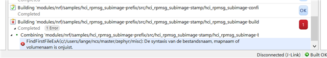

    Regarding the last error, where have you placed your project, and what does its CMakeLists.txt look like? Are you trying to add hci_rpmsg as a child image?
    Also, may I ask why you are using the master branch instead of the latest release (v1.5.1)? You are likely to have fewer issues when using the stable releases.
  • Hi, thank your for your response.
    My project is placed under the following location:
    E:\projects\2021\ble_smart_mask
    My sdk location is at:
    C:\Users\lange\ncs\master
    CMakeLists.txt:
    I'm not sure. I thought segger would do that for me if I set the right options in prj.conf. But I am very new to this environment so I am still learning. To be honest, I spend a whole day reading documentation and I am still a little confused. I just need the correct config to use BLE on nRF5340 Slight smile
    Regarding the use of the master branch, I am using it because I want to use the CAF BLE functionality in my project. It is unfortunately not present in release v1.5.1. I received the zip containing the master branch from a nordic engineer. All I did was install it through the toolchain manager.
  • Just to update you, I have also tried to compile the peripheral_lbs sample and I am getting the same error as with my own app. As a sanity check I also tested the peripheral_lbs sample using the v1.5.1 toolchain again  and it compiles/loads fine. So this is pointing to an issue with the master toolchain, not my app configuration.
  • Another update, I did the following:
    - Followed all the steps at https://developer.nordicsemi.com/nRF_Connect_SDK/doc/latest/nrf/gs_installing.html#installing-ses
    - At first I had the manually installed toolchain installed under C:\users. I got the same error as before. So I moved both project and toolchain to C:\ toplevel. It's now compiling and uploading again.

    My sensor is working again now, except I still have no bluetooth. The log shows the following:
    [00:00:00.424,316] <dbg> nrf5340dk_nrf5340_cpuapp.remoteproc_mgr_boot: Network MCU released.
    [00:00:00.432,464] <inf> event_manager: e: config_event init_val_1=3
    [00:00:00.432,495] <inf> bme680s: Config event
    [00:00:00.432,495] <inf> bme680s: Device 0x20000488 name is BME680
    My guess is it says 'Network MCU released' because I did not configure something correctly BT related Slight smile
  • Another update: network MCU released message is normal.
    I was missing a crucial bit of code in my main application, namely:
    #define MODULE main
    #include <caf/events/module_state_event.h>
    /* Let CAF know main module is ready */
    module_set_state(MODULE_STATE_READY);
    May I suggest this information is added to the following documentation:
    https://developer.nordicsemi.com/nRF_Connect_SDK/doc/latest/nrf/include/caf/ble_state.html
    I can report it's now working great Slight smile (although the toolchain is still unreliable!)
