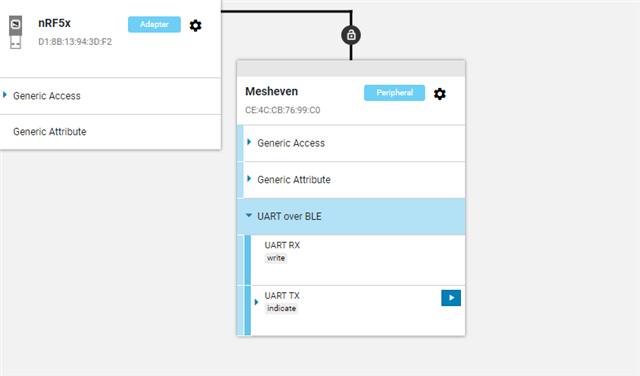

   the NRF52840 dongle can find it , connected, get it's service.
