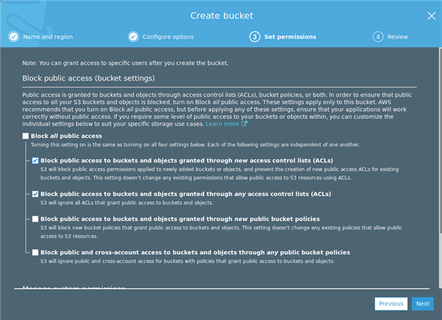

AWS FOTA using presigned URL from private S3 bucket
I've gotten the sample AWS FOTA to work on my nrf9160 using a very permissive public S3 bucket, but for production I need FOTAs to use a private S3 bucket.
According to https://devzone.nordicsemi.com/f/nordic-q-a/70753/aws-fota-download-from-s3-authentication/309614#309614, using presigned URLs is advised to allow for using a private S3 bucket. This makes sense; however, there is no documentation how to do this and I have not been able to get it to work. Would you simply append the query params to the path as shown below?

  • I am not generating the pre-signed URL myself. It is automatically generated by creating the job in AWS.
    Here is my job document:
      "operation": "app_fw_update",
      "fwversion": "v1.2.21",
      "size": 350000,
      "location": {
        "protocol": "https:",
        "host": "my-fota-secure.s3.amazonaws.com",
        "path": "${aws:iot:s3-presigned-url:https://s3.region.amazonaws.com/my-fota-secure/app_update.bin}"
    This seemed to be the method recommended by AWS. Should I only attempt the other format -- like this below?

    I think the problem might stem from IAM policies. I followed the instructions from https://developer.nordicsemi.com/nRF_Connect_SDK/doc/latest/nrf/samples/nrf9160/aws_fota/README.html
    My bucket policy looks like this:
    {    "Version": "2012-10-17",
         "Statement": [
                 "Effect": "Allow",
                 "Principal": "*",
                 "Action": "s3:GetObject",
                 "Resource": "arn:aws:s3:::bucket_name/*"
    And my permission bucket settings look like this:
    What are the permissions for your bucket?
