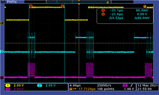

Here is my test to measure the duration of the function nrf_drv_spi_transfer :
I visualize the signal of LED0 on my oscilloscope.
Here is the result of the test :
Yellow : LED0
Blue : MISO
Pink : SCK
We can see that within 2.33µs, I have already gotten the response from the slave. However LED0 is still at high level indicating that I am still inside the function nrf_drv_spi_transfer for another 7µs, I would like to know what is the function nrf_drv_spi_transfer waiting for ? Can I reduce this duration ?
By the way, the frequency of SPI is at 8MHz(maximum), however it doesn't help me to reduce this mysterious duration of 10µs.

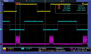

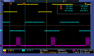

Another thing is about my ss/cs signal:
Yellow : LED0
Blue : CC/SS
Pink : SCK
We can see from the clock signal, SCK that  I need only around 2µs to get the response from the slave, However, my CS/SS signal is around 7µs, therefore preventing me to go faster for my sampling rate, is there any way to reduce this duration too ?

    Can you also give me some info on how much time it takes for your spi event handler to complete? I see that you rely on a rhd_spi_transfer_done flag to be set in the callback function. What other processing is done in that callback handler?
    If my math is correct, one CPU instruction on a 64MHz clocked system takes about 15.625 nano second to execute. So in 7 us it can execute 448 instruction. This is not such a big number for the post processing after nrf_spim_task_trigger is called. Maybe you want to fine tune the driver and optimize it even more for your need?
