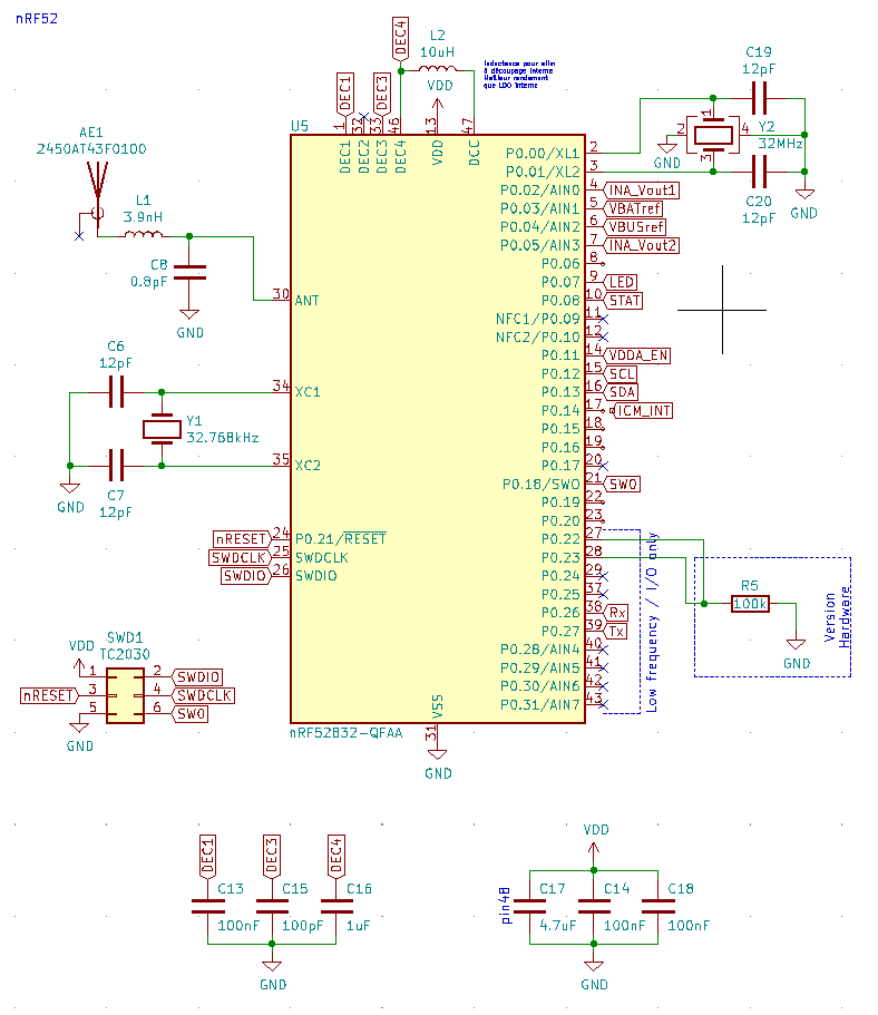

We recently made a custom board for a new project, based on the nRF52832-QFAA.
Everything looked fine in the first place as the nRF is perfectly recognized on a PC and can be flashed using nRF Connect via a nRF52 DevKit.
We even can switch the state of the LED on pin 7
So we tried to flash our custom firmware with bluetooth and serial communications (which are working well on the DevKit) but we have no sign of life coming out of our board, neither form bluetooth or serial
Our first guess was at the beginning we didn't soldered L2, so we forced the LDO in the software but nothing changed.
Then we soldered L2 to use the DCDC : nothing
We even added the small 15nH in series to L2 : still nothing
The next guess was for the bluetooth and the antenna matching, so we did the best we can to tune it but the board is still silent.
Can a bad antenna tuning can fry some specific parts of the chip ?
I joined the schematic corresponding to the nRF part of our board to let you check if we missed something.
