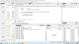

    i found this example in devzone
    ble_app_uart_throughput_test.zip
    static void send_data()
        static uint8_t counter;
        uint32_t       err_code;
        uint16_t       length = m_ble_nus_max_data_len;
        if (err_code == NRF_SUCCESS)
             m_tot_num_bytes += length;
             data_array[0]=counter++;
    for the above lines i got nearly 282KBPS

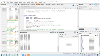

    I changed the lines to my defined one
        uint32_t       err_code;
        uint16_t       length = m_ble_nus_max_data_len,length1;
        char str[20];
        length1 = sprintf(str, "%d,%d\n",counter,counter+1);
        err_code = ble_nus_data_send(&m_nus, str, &length1, m_conn_handle);
        m_tot_num_bytes += length1;
        counter++;
    I got 23KBPS
    How do I increase the speed of it ?
