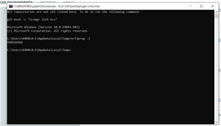

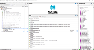

I have got a new nrf5340 DK. I have tested four LEDs and HRM. It's working fine. But when I have tried to upload blinky or hello_world Sample from NCS v1.5.1, I can't able to flash the device. I have seen the Download failed error. I have attached the image of the error which I have got.
I need help to resolve this.

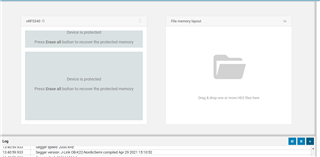

  • It would make sense that "west build --erase" works, by erasing (in the same debugging session) or recovering the chip you remove the writing protection. nrfjprog --eraseall would do the same thing.
    Though once again, I need you to confirm that the lines below still return an error. Please either run both:
    nrfjprog -f NRF53 --recover --coprocessor CP_NETWORK
    Or alternatively if you prefer west, you could run:
    west flash --recover
