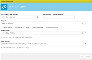

Using Window 10 Home, from nRF Connect v3.6.1, I installed the nRF Connect SDK v1.5.1. Previous I also tried to install it by the Getting Started assistant until I saw it was mark legacy.

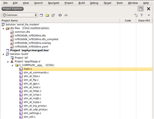

I tried from SES to open nRFConnect SDK project but the conversion importing to SES failed "FATAL ERROR: no west workspace". I ran west init & west update in the ncs folder and now I get a different error message (undefined symbols). I have been trying to get a sample to build so I can use it as a base for my project for some days without success.

Creating solution serial_lte_modem.emProject
E:/Nordic/ncs/v1.5.1/toolchain/opt/bin/cmake.exe -GNinja -DBOARD=nrf9160dk_nrf9160ns -DBOARD_DIR=E:\Nordic\ncs\zephyr\boards\arm\nrf9160dk_nrf9160 -BE:\Nordic\ncs\nrf\applications\serial_lte_modem\build_nrf9160dk_nrf9160ns -SE:\Nordic\ncs\nrf\applications\serial_lte_modem -DNCS_TOOLCHAIN_VERSION=1.5.1 -DDTC_OVERLAY_FILE=E:\Nordic\ncs\nrf\applications\serial_lte_modem/nrf9160dk_nrf9160ns.overlay -DEXTRA_KCONFIG_TARGETS=menuconfig_ses -DEXTRA_KCONFIG_TARGET_COMMAND_FOR_menuconfig_ses=E:\Nordic\ncs\v1.5.1\toolchain\segger_embedded_studio/html/configure_nordic_project_menuconfig.py

E:/Nordic/ncs/nrf/applications/serial_lte_modem/prj.conf:27: warning: attempt to assign the value 'y' to the undefined symbol NRF_MODEM_LIB
E:/Nordic/ncs/nrf/applications/serial_lte_modem/prj.conf:44: warning: attempt to assign the value 'y' to the undefined symbol LTE_LINK_CONTROL
E:/Nordic/ncs/nrf/applications/serial_lte_modem/prj.conf:45: warning: attempt to assign the value 'n' to the undefined symbol LTE_AUTO_INIT_AND_CONNECT
E:/Nordic/ncs/nrf/applications/serial_lte_modem/prj.conf:64: warning: attempt to assign the value 'y' to the undefined symbol FOTA_DOWNLOAD
E:/Nordic/ncs/nrf/applications/serial_lte_modem/prj.conf:65: warning: attempt to assign the value 'y' to the undefined symbol FOTA_DOWNLOAD_PROGRESS_EVT
E:/Nordic/ncs/nrf/applications/serial_lte_modem/prj.conf:66: warning: attempt to assign the value 'y' to the undefined symbol DFU_TARGET
E:/Nordic/ncs/nrf/applications/serial_lte_modem/prj.conf:67: warning: attempt to assign the value 'y' to the undefined symbol DOWNLOAD_CLIENT
E:/Nordic/ncs/nrf/applications/serial_lte_modem/prj.conf:68: warning: attempt to assign the value '4096' to the undefined symbol DOWNLOAD_CLIENT_STACK_SIZE
error: Aborting due to Kconfig warnings
CMake Error at E:/Nordic/ncs/zephyr/cmake/kconfig.cmake:262 (message):
E:/Nordic/ncs/zephyr/cmake/app/boilerplate.cmake:534 (include)
E:/Nordic/ncs/zephyr/share/zephyr-package/cmake/ZephyrConfig.cmake:24 (include)
E:/Nordic/ncs/zephyr/share/zephyr-package/cmake/ZephyrConfig.cmake:35 (include_boilerplate)
CMakeLists.txt:9 (find_package)
error: cmake failed
create_nordic_project.py failed (1)
