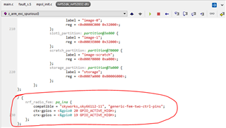

I needed assistance to get the SKY66112-11 FEM working with the Radio Test Example, for certification testing (FCC, CE etc). I am using the NCS 1.5.1 SDK. I am using a custom board with nRF52832 SoC and it has the LFXO present.
I have done the following changes
1. modify dts file  C:\Users\Luzvi\ncs\v1.5.1\zephyr\boards\arm\nrf52dk_nrf52832nrf52833dk_nrf52833.dts
2、modify prj file  C:\Users\Luzvi\ncs\v1.5.1\nrf\samples\peripheral\radio_test\prj.conf

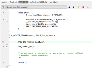

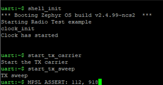

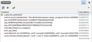

However on entering command for 'start_tx_sweep' the application stops and points an error to
MPSL_IRQ_TIMER0_Handler();
the logs are shown as follows
May i ask why does the error occur at
ISR_DIRECT_DECLARE(mpsl_timer0_isr_wrapper)

    Unfortunately,  the 'radio test' and 'direct test mode' sample are not made to be integrated with the MPSL library and these samples are only supporting the nRF21540 FEM at the moment . The conflict that causes the build error in this case is that both try acquire TIMER0.
    That said, I think it might be quite straight forward to add support for the Skyworks since it's just controlled by a few GPIOs. You can see how the nRF21540 support was added by looking at the ifdef's for 'CONFIG_NRF21540_FEM' in the source code.
