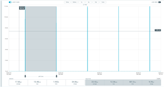

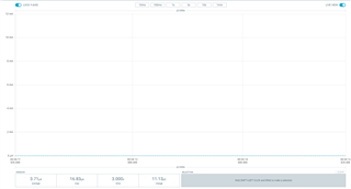

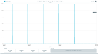

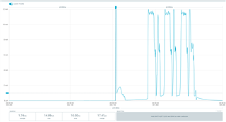

Device does not sleep after disconnection.
I’m trying to measure the current on NRF52840, SDK 17.0.2.
I have modified the HeartRate Measurement example’s advertising parameters as PLper my requirement.
I observe that while my device is advertising, the current is around 40 Micro Amps and the sleep current is 3.2 Micro Amps.
Once I connect and disconnect to the device using NrfConnect, the current is 30 Micro Amps and does not drop back to 3.2 Micro Amps.
Why is my device not going to sleep after disconnection?
