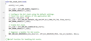

The firmware crashes when passing the ble_stack_init() when the firmware is download but in debug mode it works fine. The screen shots below shows this event.
We are using S132 and nRF5_SDK_17.0.2_d674dde
Code Snippet
On this scope shots we can see that on debug mode the test point would go low after around 2 seconds but on downloaded it didn't go low even after 3 seconds and more.
Debug Mode
Downloaded
Any thoughts on what is causing this issue?

    It seems like your clock peripheral still tries to use the external clock. Please try setting the
    CLOCK_CONFIG_LF_SRC define in your sdk_config.h file to 0 as well. If the application tries to start the LF clock while the GPIOs P0.00 /P0.01 is used for something else, this will cause issues as they can't be used for both clock operations and as a GPIO.

  • We added CLOCK_CONFIG_LF_SRC 0 but unfortunately it still didn't run.
    As a clarification we basically should leave P0.00 and P0.01 as not connected? Could we disable this inside the code or should it be physically be not connected?

    P0.00 and P0.01 will be configured as GPIOs "automatically" when you choose the RC oscillator as your LF clock source, so it shouldn't be necessary to leave them not connected.
    Can you try moving the uint32_t ram_start = 0; to after the nrf_sdh_enable_request() so that the ble_stack_init() function is identical to the one in our SDK example projects?
        ret_code_t err_code;

  • Hello Simon, we have tried your suggestion but we still encounter the issue.
    It works in debug mode but it doesn't work when the code is downloaded to the chip.

    Could you upload the main.c file here for me so I could take a look at it in its entirety, as I'm not able to spot what's wrong by the snippets you have provided.
    Do you by chance have DEBUG enabled in your preprocessor definitions in your SES project?
