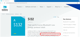

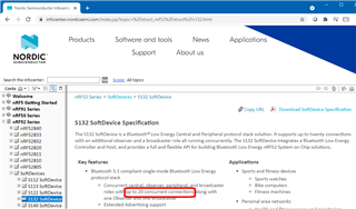

I am developing using nrf52832 (S132 v7.0.1, SDK v16.0.0) as a central and Android device (Bluetooth 4.2) as an advertisement.
During development, I was wondering about the number of connected devices.
  1. There was a definition of "NRF_SDH_BLE_PERIPHERAL_LINK_COUNT". Does this indicate the maximum number that can be connected at the same time as the peripheral?
  2. I think that the definition of "NRF_SDH_BLE_TOTAL_LINK_COUNT" represents the total number of simultaneous connections between central and peripheral, but I saw a Q & A of up to 20 units. Where can I find the materials that can be identified as 20 units?
I would like to know if there are any materials written about each.
