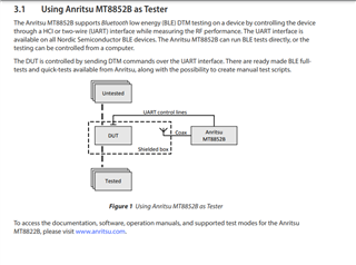

    We do have this white paper for DTM testing on the 52 series, but on page 5 you can see how to do this with Anritsu:
    I would assume that the set up is quite similar.

    For the Body SAR Testing, the device Should Be in the Continuous transmission mode@ max Power will be Radiated, which we can easily do with UART but In the Case of Body SAR, the Device must be in the mechanical enclosure as like final product, So, in that case, we can not draw the UART wire from the product.
    So now we have the only option to ready one firmware that contains continuous Transmission Mode setting @max power.
    So after flashing the firmware, the device will go into the continuous Transmission mode it means it will transmit the continuous power after turning on the device.

    if you can't access the UART or SWD interface, you have to go with the solution you have or make a FW that cycles through the AT commands you want to use for this certification.
    Here is the AT commands for production test featurs
