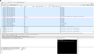

I am running a simple cloud example where I am trying to send a CoAP GET message to coap.me:5683 server over Thread.
I can ping 64:ff9b::0808:0808 and get a response. I see the ping request on the Thread sniffer on Wireshark. But the response that I see on the CLI is not visible on Wireshark
I am able to resolve the coap.me to its IPv6 address. But I do not see the DNS response on Wireshark
I try and send a simple CON GET CoAP request to the server on /test and I do not get/see a response.
I think the responses from the OTBR are not visible on Wireshark. Is there a setting that I am missing?
See the attached image. I see no responses to packets 210 and 222. The teraterm window clearly says I got a response for my PING command. And the device was able to resolve coap.me:5683 to its ipv6 address.
