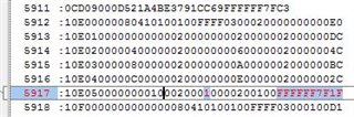

I read the programming application in client with nRFgo Studio to have the hex to compare with my application : it seems very different and I don't find the servers mesh information in flash (PERSISTENT_STORAGE).
I erase all flash in client and servers and I programmed them, the provisioning works and the communication works again.

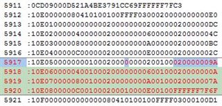

To undestand what may happened, I read application in client with nRFgo Studio to compare hex files in different configuration (0, 1 or 2 servers, after a reset,...). I discovered than after a reset, the application write some data in flash memory, in the function net_state_recover_from_flash in net_state.c there is a function seqnum_block_allocate() which writes data in flash.
I made some tests and when I reset several time the client, some data are written in memory flash.
Part of memory (.hex)
Part of memory after some reset (.hex)
Is it possible to overflow the flash memory or application after a lot of write memory in flash ?

    I suspect that the sequence number was exceeded due to multiple reset (after each reset the sequence number is increased by one block). You can read more about how the sequence number block used here.

    You are correct. The implementation of the mesh stack doesn't support repeated reset of the device (the device supposed to be line powered and doesn't reset all the time).
    It's explained in the case you quoted. What happened is that we store a block number of the sequence number in flash. Every time the device boot up it will use the sequence number from the next block (this way we don't need to store the sequence number to flash on every single increment). So multiple resets will make the sequence number jump quickly to the end of the sequence and a IV index update needed to reset the sequence number.
    What you can do is to define a flag so that when you know that you are reset in a "controlled way", you retain the value of the sequence number in RAM and then reuse the number, instead of using the number of the next block. This way it will not jump a block. This only applied for softreset, not power reset /pin reset.
    If you are doing power reset you can think of reducing the size of the block if sequence number, so that it will not jump too fast to the maximum value of the sequence number.
