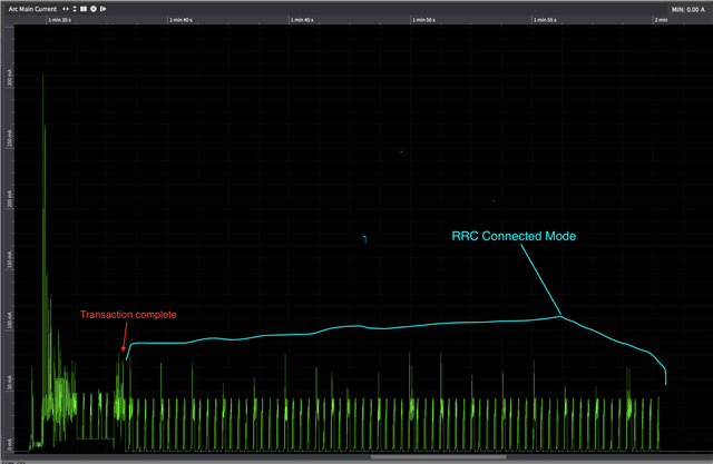

  • Ok, I've tried out using various permutations of the RAI socket options without luck.  To give some perspective, here's a typical current profile wave form of an HTTPS send and receive:
    There's ~20 seconds of RRC connected mode that I'm trying to get rid of.  My assumption is that RAI should eliminate this.

    Should I see the 20s RRC connected mode stuff disappear?  It's still there.  I have also tried:
    nrf_setsockopt(https_socket_fd, NRF_SOL_SOCKET, NRF_SO_RAI_NO_DATA, NULL, 0)
    Immediately after receiving response and before closing the socket, and there's no change.
    Am I doing this right?  Also, should I expect the 20s of RRC connected mode to be removed using RAI? At the moment, fully disconnecting and turning off the modem, and then turning it on again (avoiding the 20s impulses) has a lower average current by about 35%.
