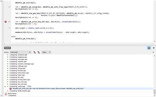

When i try to build this with the SES, deep within the librarys it fails:
But when i build it with the west toolchain via command line, it builds!
"west build -b nrf52840dongle_nrf52840 -d build_openthread_example"
What is the problem? How can i get this running in SES?

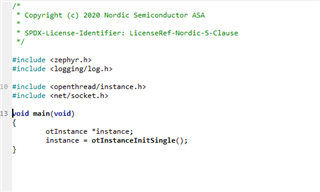

BTW the code:
Thanks
  • Hi SoerenBirth,
    Please be aware that Zephyr project samples are not supported by SES by default. West is the default building management tool for Zephyr samples. Only samples in NCS nrf folder and the supported boards as mentioned on NCS document can use SES to build and debug. From this error report, I guess the SES did not find the path of mbedtls library, because the CMakeList.txt file structure in NCS project sample is different from the Zephyr one. I strongly suggest you modify from an NCS OpenThread sample if you prefer to use SES as your debug tool.
    Charlie
