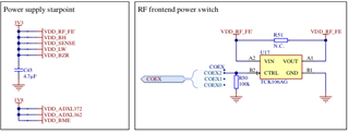

    Meanwhile, i just noticed that thingy91 v1.6.0 have power management improvements. Here is the change log "Power optimization, added circuitry to turn off RF switches when not used "
    When we look at the design deltas :
    v1.6.0 :
    v1.4.0
    i suppose i'm not the first one experiencing issues with COEX and power signals managements.
    I ordered recently from mouser they still have the version 1.4.0 stocked. so i can't test if the issue is resolved in v1.6.0.
    i'm wondering if it worth a try with the modified design like in v1.6.0.
    i would love to hear from hardware guys with more detailed reasons of this hardware change?
    do they experience voltage drops when external antenna is plugged like in my case ?
    do they still advice usign ADP5360 for custom designs and additional  power consumers ?

  • Sounds like you should have a design review by one of our HW experts. Please open a new ticket for HW design.
    Øyvind
  • i'm testing with the thingy91, my own design is a copy of it. then i'll add customs from a working base.
    Yes a hardware advice is needed
    Regards
