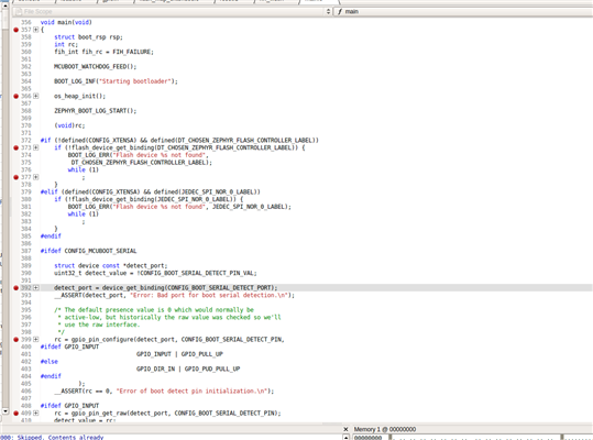

    Am I violating any rules by putting breakpoints in MCUboot? Adding a breakpoint doesn't add contents to protected areas in FLASH does it?
    Farhang said:
    It goes all the way to do_boot() but doesn't hit the breakpoint in the main() in app.
     Putting breakpoints in MCUboot should not break any rules. Could you try to set CONFIG_DEBUG_OPTIMIZATIONS=y, then it should be able hit the breakpoints.

  • I think I have narrowed the issue of hash mismatch down to breakpoints set by SES v5.34a.
    I downloaded the flash image using nrfjprog --memrd after download to the nRF52840dk and then read back immediately after, and also after debug via SES and adding breakpoints.
    A 2byte word of 0xBE00 gets spread over the flash memory everywhere I add a breakpoint. This causes the hash calculation to not match.
    I can provide a zip package with the entire project privately to you, so you can replicate.
    What is this 0xBE00 word and why is it being added to FLASH?
    I notice for 1-2 breakpoints the bootloader jumps to app fine but adding more breakpoints (e.g. 4-5), this word appears in flash. I can also tell when it happens as SES opens a "programming" progress window which disappears very quickly when I add these extra breakpoints.

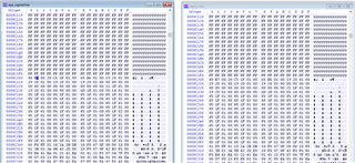

    This is the comparison of flash before and after adding breakpoints, you can see 0xBE00 add over the place where I added breakpoints.

  • It seems like 0xBE00 is the thumb instruction for a break point: https://interrupt.memfault.com/blog/cortex-m-breakpoints. However, I still don't understand how the validation for the primary image gets affected by setting breakpoints in MCUboot. Is the before and after comparison done for mcuboot or the primary image?

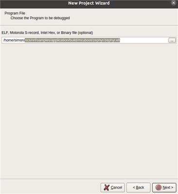

  • I was not able to reproduce this with Ozone. I did the following:
    • Copied /application (the one you sent me over PM) into ncs/nrf/samples
    • Added the following Kconfigs to nrf/samples/application/mcuboot.conf (checked nrf/samples/application/build/mcuboot/zephyr/.config to make sure they were set)
    CONFIG_PM_PARTITION_SIZE_MCUBOOT=0x10000
    • Built and flashed application + mcuboot: west build -b nrf52840dk_nrf52840 && west flash
    • Opened Ozone and chose the file ncs/nrf/samples/application/build/mcuboot/zephyr/zephyr.elf:
    • Set several breakpoints in main.c:
    • And some breakpoitns in loader.c, to see if the primary image was successfully validated
    • Then I stepped through all the breakpoints, and hit the first breakpoint in loader.c but not the other two after, so it was successfully validated. I also saw that the primary image was booted successfully, since I was able to see the log:
    *** Booting Zephyr OS build v2.4.99-ncs2  ***

  • Farhang said:
    1- Is Ozone the preferred/recommended debugger IDE for nRF NCS or is SES?
    Ozone is free to use with our development kits, so both SES and Ozone are valid options to debug with.
    Farhang said:
    2- Do you know which of the above fixed the issue?
    I tried to comment out the options below, and then set 7-8 breakpoints in bootloader/mcuboot/boot/zephyr/main.c, but I did not encounter any issues with the validation.
    I will do some more testing with SES later on
