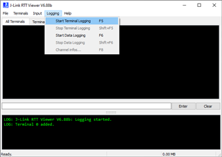

    Both can be used for custom HW as well as for the DK. The debug version includes RTT logging, which increases the size of the bootloader. It is only usable from a debugger.
    Regarding using it for release you can do it, though it often does not make sense as you will typically not have RTT access in the field anyway. If you do it, you should do some adaptations. For instance, the error handler behaves differently depending on the build type:

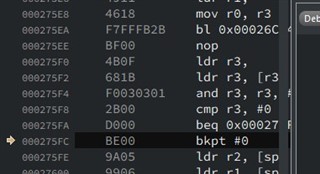

    static void on_error(void)
        NRF_LOG_FINAL_FLUSH();
    #if NRF_MODULE_ENABLED(NRF_LOG_BACKEND_RTT)
        // To allow the buffer to be flushed by the host.
        nrf_delay_ms(100);
    #ifdef NRF_DFU_DEBUG_VERSION
        NRF_BREAKPOINT_COND;
        NVIC_SystemReset();

    after i send the application the commend to set the register and restart
    it halts at Unknown function at address 0x275FC which is actually not in the bootloader address scope:
    when i press F5 then the application returns to run.. if i send the command for dfu again the jlink informs me that the register is already set
    any ideas ?
    i think the problem is this: i have tried some things but what i get after the command to start dfu from my application which is that to remind,
    NRF_POWER->GPREGRET = 0xB1;
    NVIC_SystemReset();
    i am stopped by a vector catch
    it is the same if i run only the application in debug mode without the bootloader flashed and command the app to start the dfu
    or if i debug in the bootlader after flashed and give the dfud application and then commend the running application to start the dfu i don't even send the next nrf defu serial command from terminal .. so i think the problem has something to do with the app or the command to the register
    what do you say ?
  • the dfu in the log that you see is of the first dfu
    there is nothing in the log regarding second dfu
    any ideas ?
    NVIC_SystemReset();
    what do you say ?
    I did not think about this before as you do not use the SoftDevice for serial DFU. However, if the SoftDevice is enabled when you call this code snippet:
    NVIC_SystemReset();
    that will not work. The reason is that writing to GPREGRET directly is not allowed. You need to write via the SoftDevice API instead when that is enabled, using sd_power_gpregret_set().
  • ok .. maybe that will explain that i found out that i get asserted before even reaching the bootloader
    the address 0x275FC is the assertion of NRF_BREACK_COND or something like that which i compare to the blue screen of death.. any way i will try to change and see how it goes
  • Yes, you will get a SoftDevice fault with reason NRF_FAULT_ID_APP_MEMACC in this case. (A god tip is to enable logging when testing the app as well. If you tested the app with debug logging enabled you should have seen "SOFTDEVICE: INVALID MEMORY ACCESS" in the log.)

    <info> app: Inside main
    <debug> app: In nr
    After "Initializing nrf_fstorage_nvmc backend." the next line is "Enter main loop" which is the first line that is logged by the bootloader. So apparently here has been a reset for some reason. There is nothing in the log indicating why, though. Do you have a watchdog active or could it be another reason for the reset?
