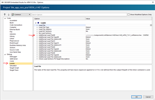

    5. when using segger ide to flash an app on an erased device, there is no need to flash the softdevice separately, so i guess it is doing it by itself, how does it work when wanting to use segger to flash app when a bootloader is on the device ?
    The example SES projects we provide include the SoftDevice as an additional load file, so it is programmed together with the application when you program from SES:
    SES will program the SoftDevice and application without any problem when you have a bootloader. But the bootloader cannot start the app so you will not be able to run it unless you program a valid settings page for every time you change the app, or alternatively modify the bootloader as I mentioned earlier in this post.
