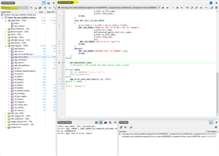

  • Thank you Vidar! This is great, I will sift through these later today. I can already see where I went wrong. Curious though, what would values be for NRF_BLE_SCAN_SCAN_INTERVAL, WINDOW, and DURATION? Are they unchanged from the default values the SDK gives?
    UPDATED: After making sure the above parameters were set correctly, I'm getting sporadic behavior from the DKs. They are constantly connecting and disconnecting. Apologies for not mentioning earlier but my central device is using the multilink example but configured for long range per diff file you sent. Could this behavior be cause by something in the multilink_c example? My only other thought is a difference from SDK 16 to 17 that is disrupting the long range configuration.
    Your help is much appreciated.
  • I left the scan paramaters unchanged, but you are free to adjust these if you want. The trade-off is discovery time vs power consumption.
    This could be a symptom of an assertion in your code. Are you able to debug the multilink project and see if the program ends up in the app error handler function (see Error module)?
    Debugging with Assert with SES
  • Hey Vidar,
    After some debugging I was able to resolve this behavior that was caused by an unrelated bug. Successfully able to make connections in CODED PHY now with the parameters you listed in your reply.
    Many Thanks!
