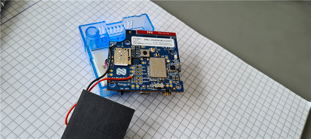

Hi Dev team,
My question is related to the charging of the Thingy91 battery through solar panels. I have a solar panel connected to the Thingy on the points TP11 (Vbus) and GND (TP16).
Is this the right connection for the solar panel to the Thingy91 ?
I wanted to know a way wherein we can know if the solar panel is indeed charging the battery of Thingy91 or not, possibly through software.
Adeel.

  • Hello I know it is an old thread but, did you have any luck connecting a solar panel output to the 5VBus? how does the thingy behave with the voltage fluctuations because of the light intensity changes? in theory, it should just work because you were replacing the 5V from USB to a different source in this case a solar panel that has to be within PMIC operational voltage range 4~6.7v
