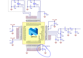

Hi, I came across a forum post that NRF51 had an issue with noises in SWCLK signal.
For the design, do I need to attach an external pull down resistor in design? If so, what are some recommended resistances?
Yes, 1k ohm as shown in reference design:
regards
Jared
regards
Jared
