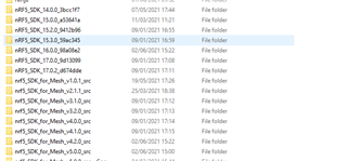

Hi Mttrinh,
Thank you very much.
I still met some bug,
1) could not find Could NOT find Doxygen (missing: DOXYGEN_EXECUTABLE)
2) Could not find `patch` executable. Automatic patching of the nRF5 SDK
3) Could not find the nRF5 SDK. The build will fail.
I don't know where the nRF SDK should add
Could you help me please?
Hi Mttrinh,
The nRF5 SDK folder should be adjacent to the Mesh SDK folder. Like this:
