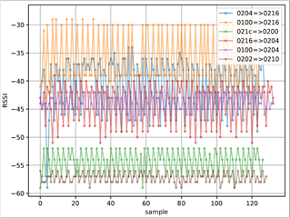

Hi there,
We have a mesh network which runs now for quite some time on our own hardware. We are using heartbeat messages to collect RSSI values between nodes in the network and relay them to a gateway. The heartbeat message is send in intervalls of 10 seconds. We can see a fluctuation of the RSSI values over time and some repeating scheme for allmost all collections. We additionally saw that the channel on which the messages are received repeats with the following scheme (37,38,39,37,38...). The question is know, is it possible that the RSSI fluctuates +-10dB between different channels? Its clear for me, that the RSSI can variate over time, due to various influences (Receiver, multipath, fading, etc.). Is this a known problem?
