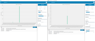

nRF52833-DK DTM test warning
Could you pls check, is it ok if these logs happened?
No firmware defined for selected device
Please make sure the device has been programmed with a supported firmware
(sdk17.0.2 dtm test, nrfConnect 3.6.1, pca10100.hex, nrf52833-dk)
Anyway seems all works fine transmit and receiving.
  • Hi Ivan
    As long as the test starts without reporting an error it should be fine. If the target board is not programmed correctly you won't be able to start the test.
    Can you try to press CTRL + R and do the test again?
    This will reload the application, and most likely you will not see the same warning.
    Best regards
    Torbjørn
  • CTRL + R did not help, anyway looks like the application works as well!
    One more question, Am I right it's impossible to see the transmitter device during the scan with nrfConnect for mobile appl?
  • Hi Ivan
    That is correct.
    In DTM mode the radio is not sending full Bluetooth packets. Instead it is enabling the radio in a constant carrier mode, and the data is simply a sequence of ones and zeroes, or a sequence of pseudo random numbers.
    This will make the carrier visible to a receiver in DTM mode, or a spectrum analyzer for lab testing, but not to regular Bluetooth devices.
    Best regards
    Torbjørn
