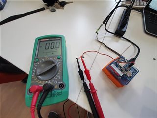

I got a Thingy91 and I would have liked to be able to measure the current that passes through the NB-IoT modem, for that, I followed this tutorial :
https://infocenter.nordicsemi.com/topic/ug_thingy91/UG/thingy91/hw_description/hw_power_current_measurement.html
Here the result:
I cut the SB3 bridge and soldered headers to make the measurements. I checked the soldering, headers, cables, everything is functional.
If I use a Jumper on my header, it works, I can use my debugger and program with it, if a program is flashed it works and if I want to update the firmware too. But if I connect my multimeter to pins, it does not work anymore. (I check the connection). Do any of you have an idea of the problem? Did I miss any information?  Thank you.
