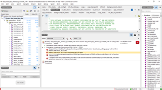

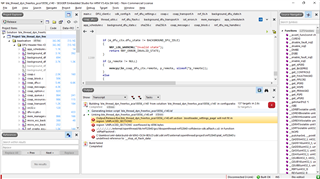

Hello
I had integrated the DFU client stack in ble_thread_dyn_hrs_coap_srv_freertos  project.
SDK : nRF5_SDK_for_Thread_and_Zigbee_v4.1.0_32ce5f8
After clearing all the errors i facing the new error that is
Output/Release/Exe/ble_thread_dyn_freertos_pca10056_s140.elf section `.bootloader_settings_page' will not fit in region `UNPLACED_SECTIONS'
region `UNPLACED_SECTIONS' overflowed by 8192 bytes
can anyone help me in solving this error.
Thanks in advance!!!!

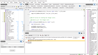

    Which toolchain are you using? Have you used <SDK>\examples\zigbee\ota\client\ as reference? If so and you use SES, then you should look at the flash_placement.xml and do the same in your project (search for bootloader_settings_page).
  • Which toolchain are you using?
    7 2018-q2-update
    No
    i did the same thing im still getting the same error
  • I am a bit confused. Do you use GCC and Makefile (as you write 7 2018-q2-update) or Segger Embedded Studio, as you paste that screenshot? Can you upload the project files so I can see if I spot anything obvious (Just the Makefile and linker script if using GCC and Make or SEs project files and linker configuration XML file if using SES)?
