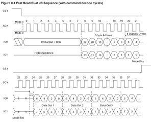

qspi write more then 16 byte gets scrambled after 18 byte
hello Nordic
i work with nrf52840, SDK16.0 S140
i use QSPI for writing to an external flash (IS25LP064A)
if i write 16 bytes then its all ok but if i try to write more then i don't get the values i put after the 18 byte
i tried first with 240, then 24, then 16, then 20 (all aligned sizes).
here how i init the QSPI:

this is the configuration commands for the flash:
and here is my write command:
err_code = nrfx_qspi_write(syntetic_240_buff, AUDIO_BUFF_SIZE, audio_address_mark);
audio_address_mark += AUDIO_BUFF_SIZE;
any ideas what causes this ?
