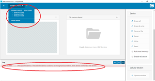

I am unable to connect the device to nRF Connect programmer. Following is the error. how to resolve it? what actually is the problem?

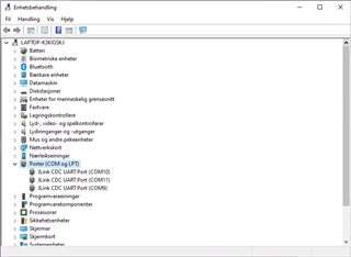

Hello Timothy,
Thanks for the pictures! The 3 COM-ports are supposed to be registered as “JLink CDC UART Port”.
Are you sure that you are using an USB data cable and not one for powering only?
Markus
