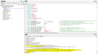

    In order to simplify my question, I would like to know how to Combining two example files such as : \xxxx\examples\zigbee\light_control\light_bulb and \xxxx\examples\peripheral\uart from the actual SDK for Zigbee.
    I've tried to merge both, but file doesn't compile and work. I not sure if there is a tool in order to do that, but I've also tried to do manually and it not working.
    See the print screen error attached and Identified in yellow:
    This is also what I'm trying to implement with the serial communication. Serial Data needs to be issue when a command has been executed via Alexa, using the Light Bulb SDK.

    There is no tool to merge examples for you, unfortunately. In order to merge two examples you have to copy the functionality you want from one example to the other, and add the files to user include directories and the .c files in SES.
    From your error I see that it cannot find the file app_uart.h. Most likely it has not been added correctly in SES.
    To add it to user include directories do the following:
    • Right click on Project 'zigbee_light_bulb_pca10056' and select Options...
    • Make sure the configuration is set to Common, and not Debug or Release
    • Go to Preprocessor and double click on User Include Dircetories to open it
    • Add the following:
      ../../../../../../../components/libraries/uart
      Be aware that the path must be correct. It seems you are using the light bulb example, so I believe this should be correct, but you can compare it with the other directories there to make sure. A lot of them should be libraries under the components directory, so just make sure you have the same amount of "../../" before the components directory in the line you add as there are in the others.
    To add the .c file:
    • Right click on the nRF_Drivers folder in the Project Explorer in SES
    • Select Add Existing File...
    • Go to the location of the file (<T&Z_SDK>/components/libraries/uart)
    • Select the file app_uart.c
    Please let me know if you are still having issues after going through these steps.
