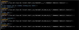

AT%XMONITOR
Hello
I am working with aws_iot sample and over this I add gps functions (handler and work init) belong to agps sample, I probe AT%XMONITOR command and show me this

When I run the example, this happens:
 RRC mode: Connected
//aproximatly after 4 seconds
RRC mode: Idle
// aproximatly after 60 seconds
RRC mode: Connected
and so on, but gps don't active in any time
how can I control the time between Idle and Conneted mode (in this case 60 seconds)?

     Yes, this seems correct, however, the last last periodic tau "01011111" means 6 minutes x 31 = 186 minutes from the XMONITOR documentation.
