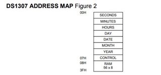

I'm trying to read the values from the DS1307 RTC through TWI.  I've established a connection with the device but am not sure I'm using the nrf_drv_twi_rx() function correctly.    When the log is viewed it prints that there was a device successfully detected at the given address and that 7 bytes are received over TWI to the rx_data array which is an array with 7 uint8_t.
From what I read about the nrf_drv_twi_rx() function I thought that passing it an initialized twi instance, device address, buffer to hold data, and amount of data to receive that it would automatically read from the correct device registry locations.  The problem is that the outputs I get are not related to the clock time and vary from 0 to 80. I'm not sure why these values are not the clock values.  From the DS1307 datasheet the memory addresses are listed as follows:
I'm not sure what the 00H-3FH address notion means as I would expect a binary or hex address for a memory location, so any help in understanding what these addresses mean would be helpful as well. The following paragraph from the datasheet describes how the data is to be accessed:
"The time and calendar information is obtained by reading the appropriate register bytes. The contents of the time and calendar registers are in the BCD format. Bit 7 of register 0 is the clock halt (CH) bit. When this bit is set to a 1, the oscillator is disabled. When cleared to a 0, the oscillator is enabled."

  • Through some further troubleshooting I changed the rx_data array to hold 63 uint8_t and to get 63 bytes from the nrf_drv_twi_rx() function.  The correct date and time info (7 bytes holding info about sec, min, hour, month, etc) is all contiguous, but each time the program runs the group of correct information moves down one space in the rx_data array (ie: if sec, min, hour are in spaces 0, 1, and 2 the first build/run, the second build/run they are now in spaces 1,2,3 respectively).
    The datasheet says that: "During a multi-byte access, when the address pointer reaches 3Fh, the end of RAM space, it wraps around to location 00h, the beginning of the clock space."
    Based on this, it seems that the address pointer is not correctly resetting to the beginning of the clock space each run which is causing the offset.
    I can't find information in the development library about how the nrf_drv_twi_rx() function knows what to use for the address pointer to read data from the slave device, or how this pointer is controlled.  Could someone explain how to alter the address pointer being used by the nrf_drv_twi_rx() function?  Or let me know if you think there is some other problem.  Thanks!
  • "The DS1307 then begins to transmit data starting with the register address pointed to by the register pointer. If the register pointer is not written to before the initiation of a read mode the first address that is read is the last one stored in the register pointer. The register pointer automatically increments after each byte are read."
    Expected operation is to transmit the required address to read - 0x00 in this case if wanting to read the time - before each read of the time. That requires a single byte write nrf_drv_twi_tx() before each nrf_drv_twi_rx() or better a combined write of 0x00 followed by a read in the same twi/i2c function; this is possible with the i2c driver but I don't use that so can't advise.
    Using wrap-around is not reliable; in any case 56 bytes RAM plus 8 bytes time = 64 bytes, so using an array of 63 bytes explains why the data moves 1 bytes each read of 63 bytes. 64 bytes would work but is not recommended ..
