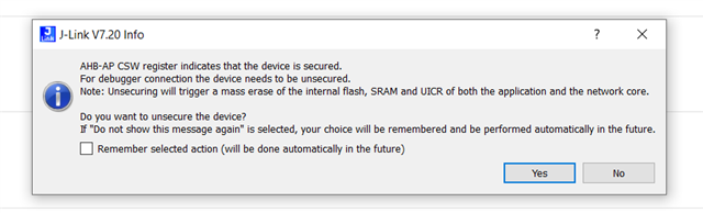

When i program our new nRF5340 based radio boards the program returns Device Protected for both cores on completion. It is also impossible to debug the board as my segger refuses to connect.

This does seem to allow the debugger to connect, However i get a hard fault from the command.
Is there a suggested way around this issue?

    so i m expecting  to attach the debug without problems but not.
    So  HOW TO  DO?
