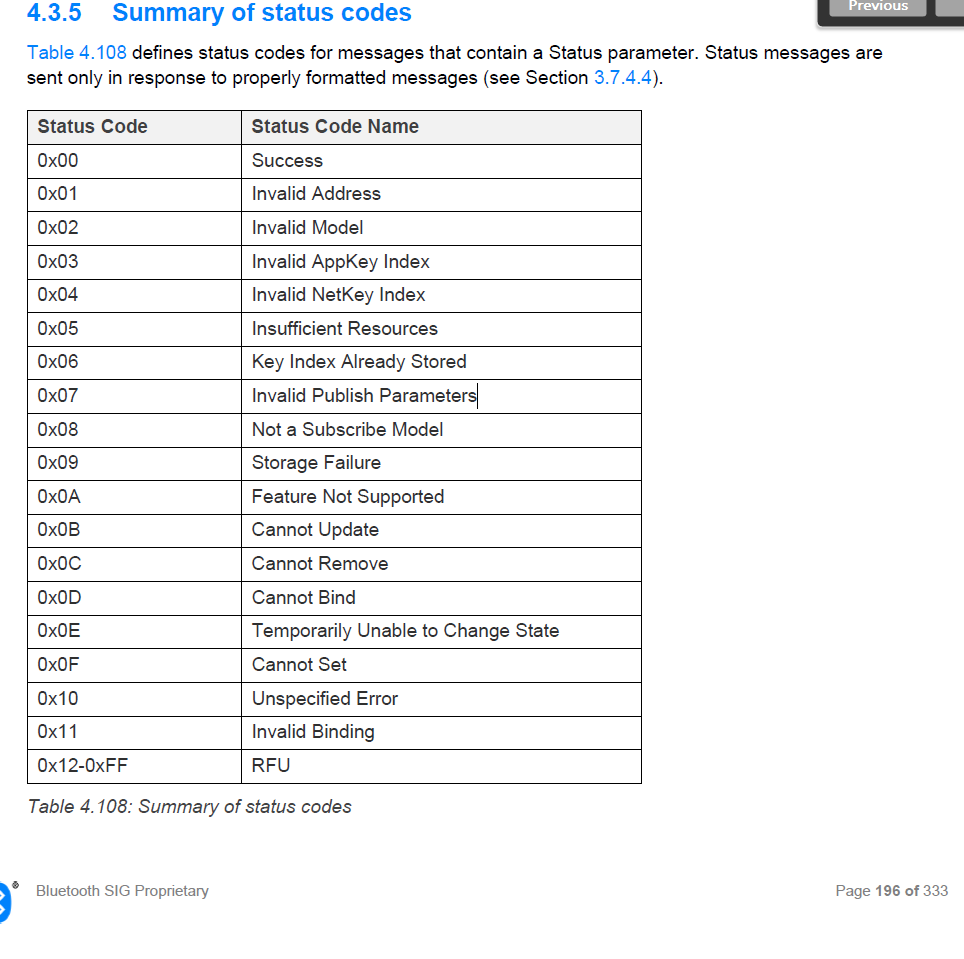

    <t:    1085142>, node_setup.c,  282, opcode status field: 7
    <t:    1085145>, main.c,  191, Configuration of device 0 failed.

  • Hi Charmin,
    Status field 7 means Invalid Publish Parameters.
    What I can see in the log is that you were trying to write to  "Sensor setup server". And it seems that in the node_setup it use the same parameter to the "Sensor server" . So most likely "Sensor setup server" doesn't support periodic publication and you shouldn't send the publication set with step_num = 1 to the "sensor setup server".
    What you need to do is to split the setup for _SENSOR_SERVER  (for example case NODE_SETUP_CONFIG_PUBLICATION_SENSOR_SERVER) in config_step_execute() and change the parameters for these cases only, not all as you do now.
