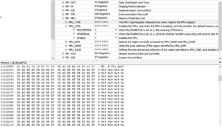

    Not sure if I have encountered this type of fault before, but I found a blog post that suggests that this error is raised when the CPU attempts to execute code from a memory protected region.
    IACCVIOL - Indicates that an attempt to execute an instruction triggered an MPU or Execute Never (XN) fault. We’ll explore an example below.
     https://interrupt.memfault.com/blog/cortex-m-fault-debug
    Could this be it, or are you not using the MPU in your project?
    Vidar
  • Hi Vidar,
    Thanks for the article link, I'd actually already run across it (it's super useful for figuring out the debug).
    We are not directly using either the Cortex MPU or the Nordic MWU.  Are either of those used by any Nordic libraries or drivers?

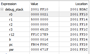

    Unfortunately, having any sort of debugger attached while running prevents the hardfault showing up at all, which would tend to suggest some sort of timing issue.  Using a UART has the same effect.  I can attach to the running chip after the hardfault has happened, to see the state of things, but I can't watch the fault happen (which also means not getting the debug output).
    The stack frame passed to my HardFault_process function looks like this:
    And the CPU registers (according to Ozone) are:
    As the stack guard library uses the MPU, wouldn't it basically show the same symptom, i.e. an instruction access violation, if the stack was triggered?
    I've had a go at the old-fashioned "write DEADBEEF to the stack at start-up" method, and that suggests that this code isn't actually over-running the stack.  At the point a hardfault has ocurred, connecting after the fact via Ozone shows that 0x2001E000 is all DEADBEEF still.  I've also confirmed again via MPU_CTRL that the MPU definitely doesn't think it's enabled.
    So, all in all, it doesn't look like stack overflow is the issue here.  Which brings us back to a wierd hardfault that doesn't seem to have any obvious cause, but occurs repeatably.
    I agree, it doesn't sound like you have had stack overflow, but the PC value (0xFB04F85C) on stack is clearly invalid, so that must be the reason for the hardfault.

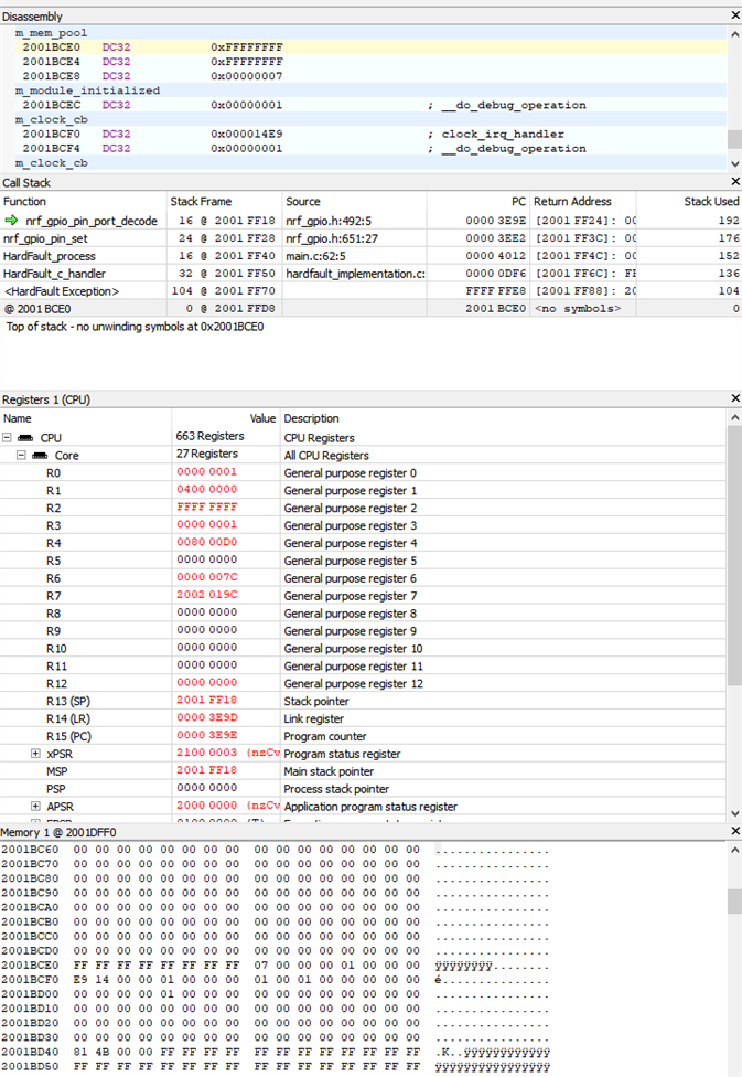

  • Ok, the delay_ms call was a red herring, and obvious in retrospect - that's being called from the hardfault handler (to flash an LED), so it's not where the problem is ocurring.  Doh.
    Commenting it out made it obvious, as then the PC ends up pointing to the nrf_gpio_pin_* functions, which are setting the LEDs.  This also caused the resultant hardfault to change to an IBUSERR instead - the call stack included a call to __WFI(), which is slightly different.
    We do use __WFI() a fair bit to cause the CPU to sleep (and consume less power) when waiting for things to happen.  Most timing is provided via an RTC, plus a few external interrupts.  As above, we don't use a softdevice, so it shouldn't be a problem to call __WFI() directly, but a bit of digging around suggested that the following is better (we do use the FPU):
    static inline void sys_sleep (void)
    #if (__FPU_USED == 1)
      __set_FPSCR(__get_FPSCR() & ~(0x0000009F));
      (void) __get_FPSCR();
      NVIC_ClearPendingIRQ(FPU_IRQn);
      __WFI();
    Replacing the WFI calls with that changed the hardfault to an UNDEFINSTR error instead.  Looking at the top of the call stack, I now seem to be somewhere in the heap, I think?
    So yes, that's probably not a valid instruction.  But how did we end up there in the first place?  That particular address happens to be the m_mem_pool long, from the Nordic mem_manager library (which we use to provide pseudo-dynamic memory allocation).  Looking through mem_manager.c, I don't see anything obvious that could turn into a "JMP &m_mem_pool" or similar - it's a status flags bitmap, so the usage is all setting and checking bits.
    The Hardfault library stack frame snapshot now looks like this:
    with the LR pointing to the WFI instruction in the above sys_sleep code.  So it seems to be something to do with the WFI call.
